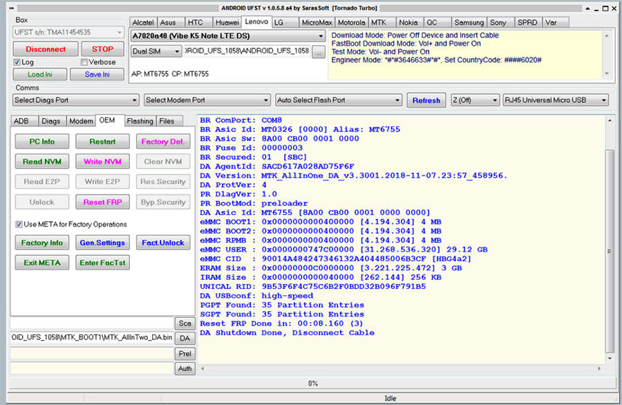

Tornado UFSx Turbo Android UFST v1.0.2.9
v 1.0.2.9

[Backup MTK] to backup all partitions of MTK based products.

MTK
[Read Flash], [Write Flash] is Enabled.
Tested on: MT6572, MT6582, MT6583, MT6589.
Read, Sparse Read, Make & Edit Scatter, Repair PMT, Format, Flash, Dead Flash ...
More MTK SoC's comming soon.

MTK
Changed Strategy of READ and WRITE Defaults (Just Check on Setup Window).
Improved Read Algorithm, especially for -5 Error:
Be Sure Battery is Fully Charged, Less than 30% Causes USB Connection Down,

Enabled [Use META for Factory Operations] Option to Write Digits and
Label S/N (not need Root) Use [Gen.Settings] Button.

Tornado UFSx Turbo Android UFST v1.0.5.5
v 1.0.5.5
Before Using [MTK], [QC], [SPRD] Tabs Always Check [Var] Tab for predefined !
COMMON
Minor Bug's Fixed in File and Model Selection.
INI File Saving time decreased.
[FPGM],[Re-Partition],[Use FastBoot] now Saving to Ini under Model Settings.
Loging to File Added (Tick [Log] CheckBox in [Main Box Functions] Tab)
Re-Tick of [Log] Will set New LogFile name (with Current Time Stamp)
More Sophisticated USB Exceptions Handling with Tips where was a Problem.
[Dev Mang.] Button adde to quick Launch Device Mannager.

Enabled [Reset FRP], Use [ADB Mode (via Menu...)], ADB Must be Enabled.
To Enable ADB use Trick with *#*#4636#*#*, Aptoide and Test_dpc_smart_manager.
Note - MTK Models FRP Can be Done in Flash Mode.

[Format Flash] Function Added.
Format (Erase) Can be Done by Linear Address or Partition Name.
[Read Flash] Preloader Analysis and Extraction (to SPFL Format) Added.
Preloader now is saved as 2 Files:
preloader_partition.bin (Whole Partition), Flashable by UFST and
preloader_blabla.bin (Extracted SPFL File), Flashable by Original SPFL.
Blocked Write of Wrong Preloader File (Must be in Partition or Original Format)
[Factory Info] will Show Unlock Keys in Meta Mode (If is Allowed)
Enabled [Fact.Unlock] Button, Unlock in Meta Mode (If is Allowed)
[Enter FacTst] Button added, to Boot in Factory Test Mode.
Non Readable Partitions now Skipped, not Generate Fatal Exception.
SIGN Update of Signed Devices [SBC] Fixed (Blink, not Start or Loose Digits)
Note: not Original or not Signed Files will not cause Signature Update.
Warning About MTK Signed Devices [SBC]:
Must Flash Original Signed Files, Otherwise Device will not Start or Blink.
If Have no Idea is Signed or not, Backup All, before Flashing !
Some Paranoid "Secured" Devices cannot read at all from Flash Mode,
but can be Root-et and Read via ADB ...
If Device need Signed Images, can flash Only SAME Version from other device.
All this "Security" Paranoya not Affect a FRP, it can be done on all Devices.
PMT Writing Bug on GPT Devices Fixed (DL_SET_A4 or DL_SET_A9 Error)
MT6592 Write Flash Bug Fixed.
Indicator of non Existent Files in Setup Form before Start Flashing.

WORLD FIRST NOKIA 7 PLUS FRP REMOVED SUCCESS BY UFST 1.0.5.9R BETA TEST
MOTO E3 POWER FRP REMOVED SUCCESS BY UFST 1.0.5.9 R BETA TEST
