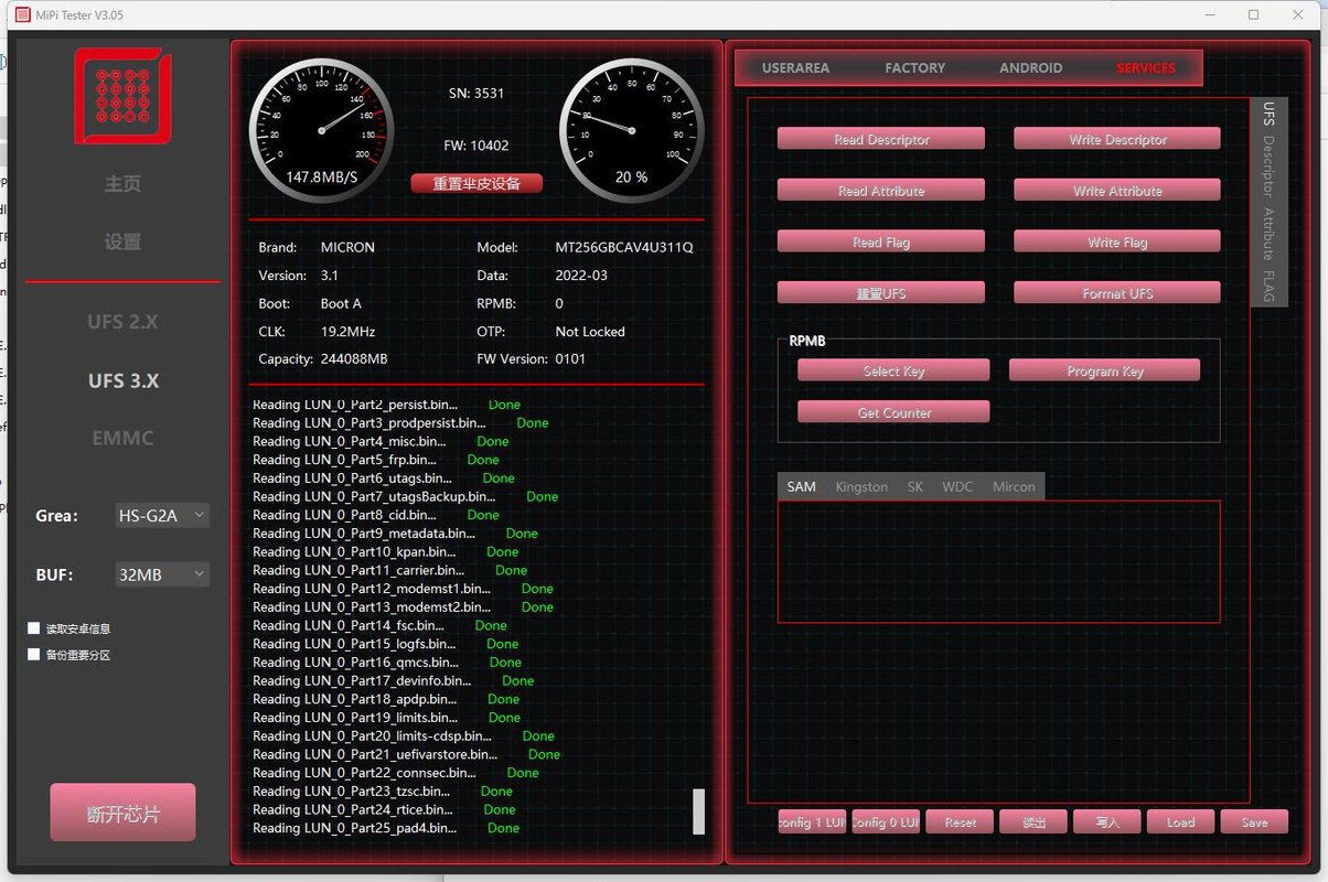

Preview, next update UFS add read and write 360MB/s. ISP need testing

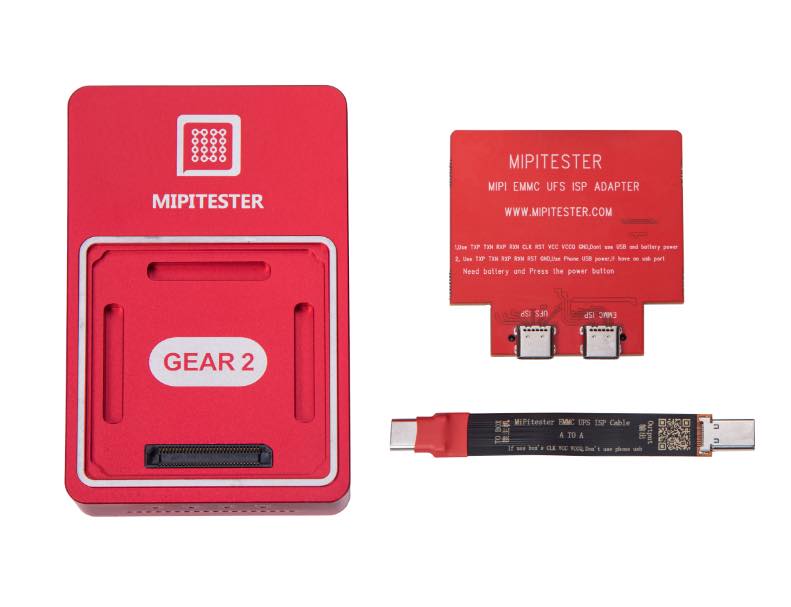

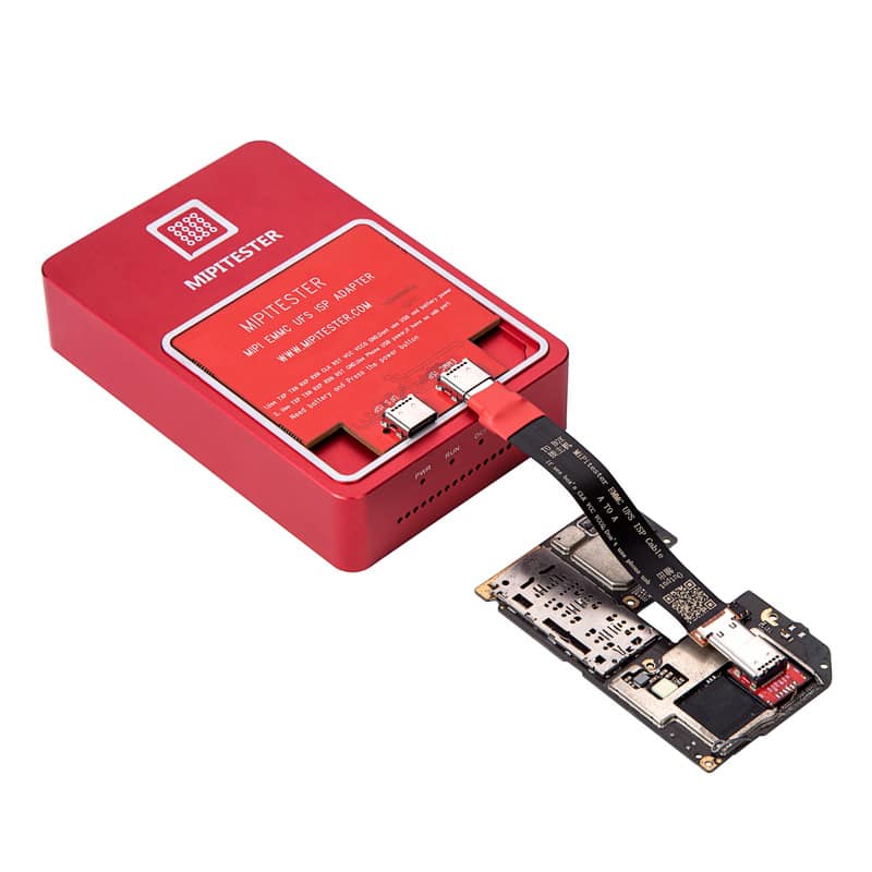

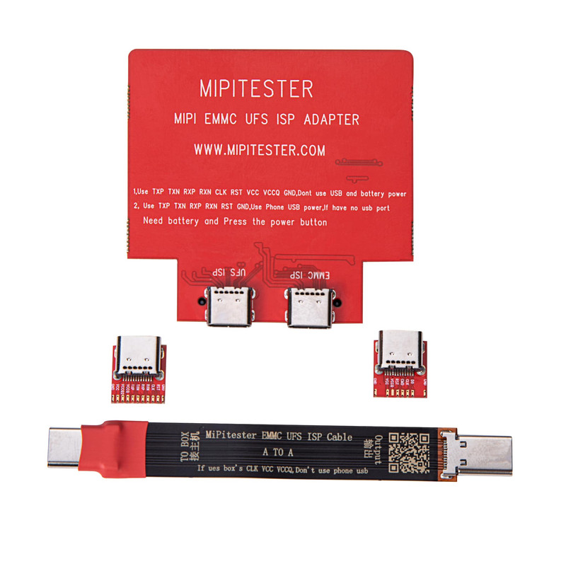

The first in the world to support UFS high-speed ISP reading and writing.MINI
and Gear 2 support UFS HS-ISP just need TXP TXN RXP RXN 4 pins ,read and write 200MB/s
UFS does not need to be disassembled

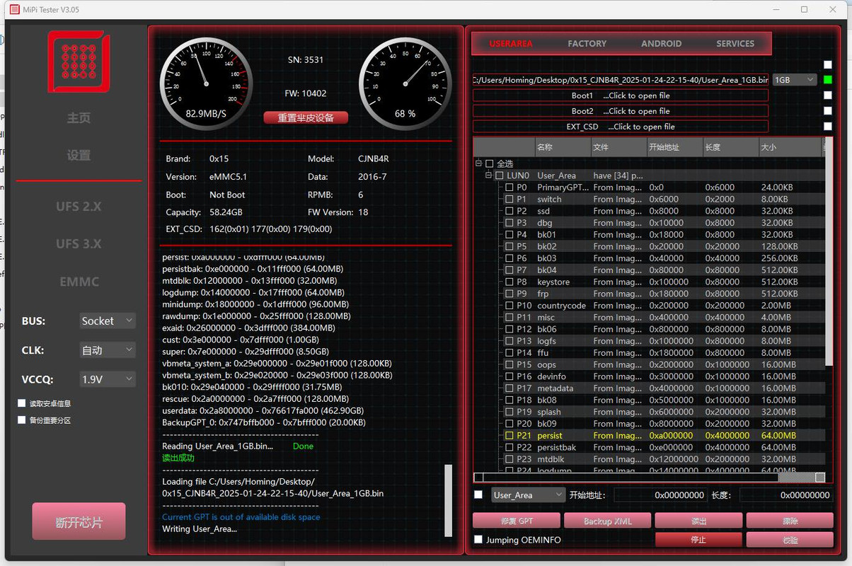

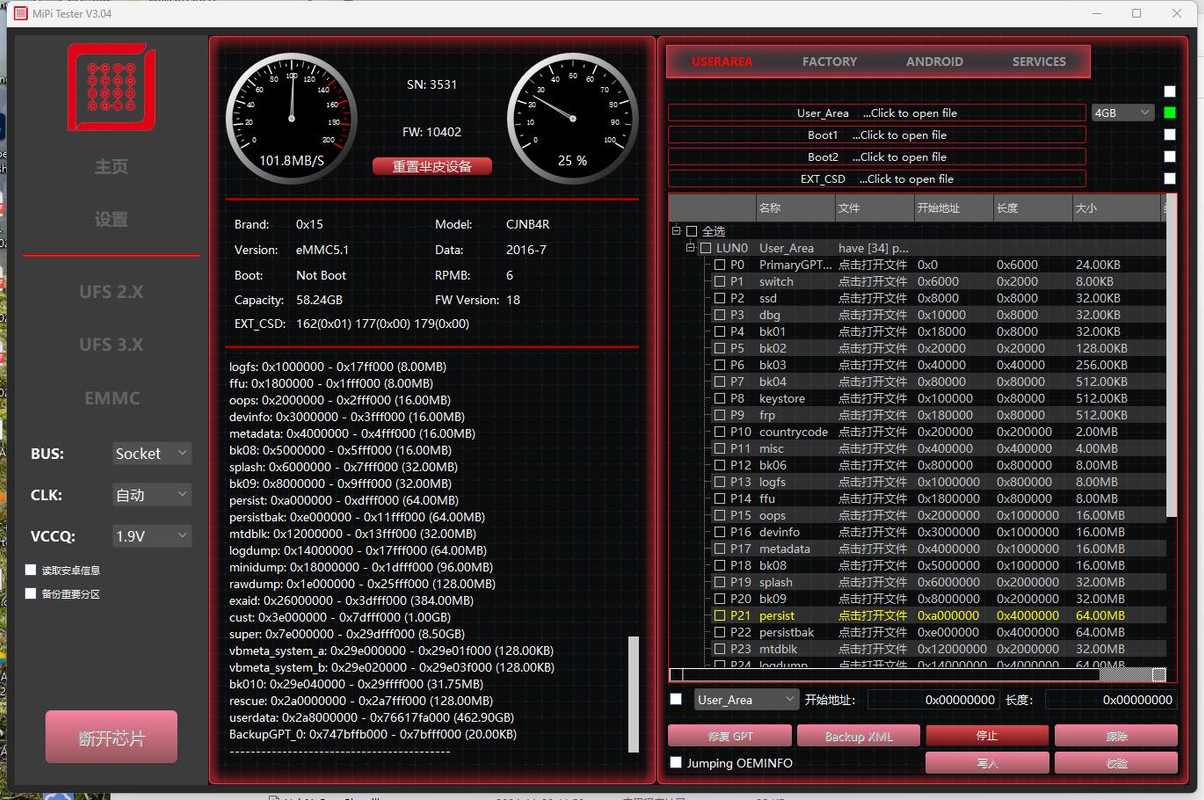

1. Added the function of writing files in different folders in the Partition interface
2. Added the function of retrying to write data after writing failure
3. Fixed the problem of slow verification speed
4. Fixed the problem of incorrect address of BKGPT file writing in the Factory function
5.Add Samsung Skhynix remove write-protection
6.Add fixing High temperature bad block
7,New reset Reset UFS (pleasant surprise)
8,Add samsung skhynix Mricon Toshiba unlock config
9,support txt xml tar md5 files
10,add read RPMB emmc UFS
