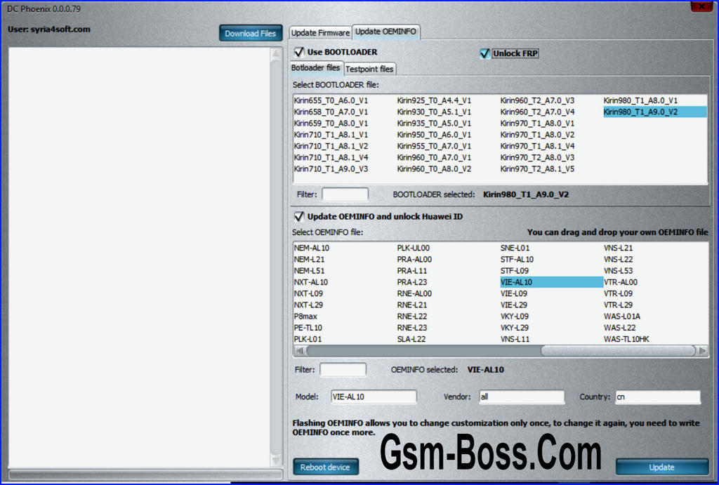

DC-Phoenix v.112 update
Old flash option - usable for old mobiles with
HiSilicon Kirin960 & Kirin659 processors
This gives stability and flashing error avoidance
whereas using current standard method gives
mid-flash error
software hang
stuck problems
Fixed Unknown error connecting to server bug
which occurred during flash attempt
when user did not have enough credits for service to be initiated successfully

Warning MUST READ
1. DC-phoenix can be used with HCU timed license account
(unlimited access to DC-Phoenix software for 72h for 1 device)
Account creation HERE. HCU tool link and what it is read HERE
2. DC-Phoenix will attempt to remove firmware validation in which case phone
may not check firmware and accept incorrect one, be aware!
3. Phone must be charged up before any kind of flashing otherwise it might go dead.
4. Remove SD card from the phone if it is inside.
How to repair bricked Huawei phone
Repair only not working mobiles! If you want to downgrade security click here
Method 1:
Can be used when phone in bootloop, stuck in fastboot etc.
Can be used for region change. Detailed guide for region change here
You should start repair attempt from this method including mobiles
with Kirin980, Kirin710, Kirin810
WARNING: DO NOT USE BOARD SOFTWARE FROM OUR SUPPORT AREA FOR METHOD 1
Step 1
In Standard mode Select firmware
(use same customization version as one in mobile if you know which one it is)
+ customization (optional) + preloader (if exists),
must start flashing in fastboot mode while "Rescue recovery"
option on software is selected!
If mobile has Kirin659 or Kirin960 cpu then put a check mark on "Old slow algo" too.
If during flashing mobile does not enter into upgrade mode
(you get message) do it manually. Turn off phone, hold both vol buttons
and connect device to cable, keep holding buttons until you see Huawei logo
and then attempt to write same file.
IMPORTANT: Do not attempt to write APP files in fastboot
without Rescue Recovery option! This will cause additional problems!
If this method did not help, read Method 2
Method 2:
Not suitable for Kirin710, Kirin810 , Kirin980, Kirin990
Step 1
Rewrite OEMINFO with model, vendor and country matching your full stock rom file data
that you want to flash into your device.
For mobiles with new version possible only via testpoint.
Step 2
After rewriting OEMINFO you will be able to write any region's full stock firmware file
in UPDATE mode once (Can do it with DC-Phoenix or from SD card).
Select "Standard" in DC-Phoenix .
IMPORTANT:
if you want to write another file, you will need to repeat  step 1.
Step 3 (required if no imei, sn, mac or other data missing)
HCU repair as empty board guide HERE
Method 3
Full repair phone as empty board:
Not suitable for Kirin710, Kirin810 , Kirin980, Kirin990 and with part of latest kirin970
